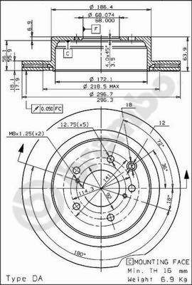

Nebo takhle, snad :oops:
Kotouče Z32.jpg (33.48 KiB) Zobrazeno 7323 x
